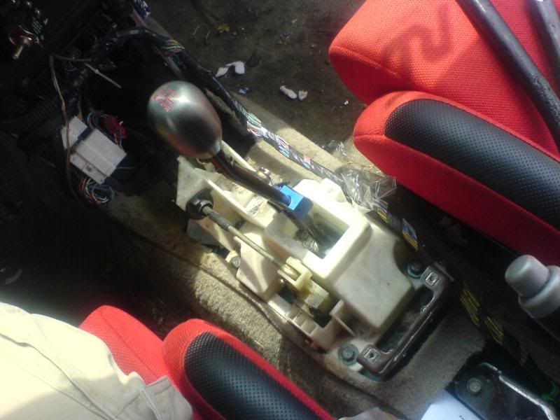

The first part of the DIY is Exposing the shifter its self so it can be removed:

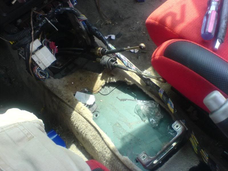

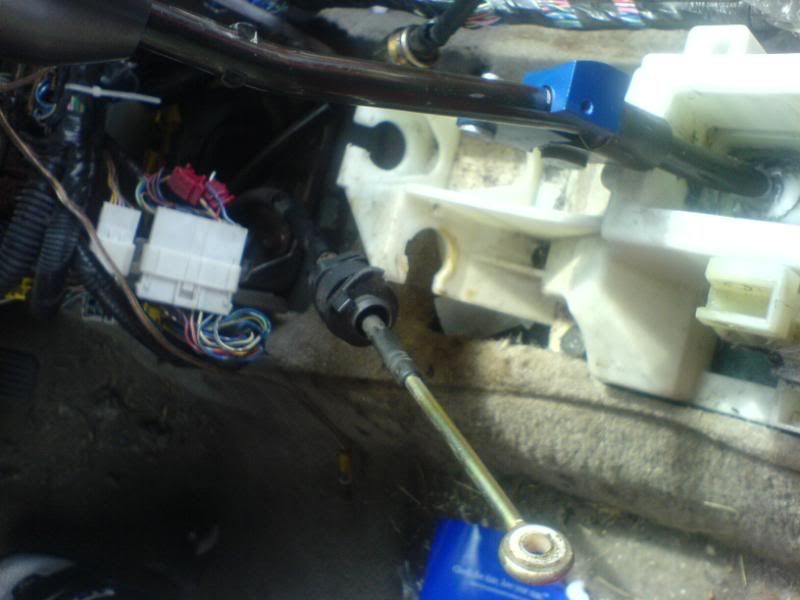

Next you must disconnect the shift linkage from the shifter as well as the body of the shifter (the body is done by 2 clips):

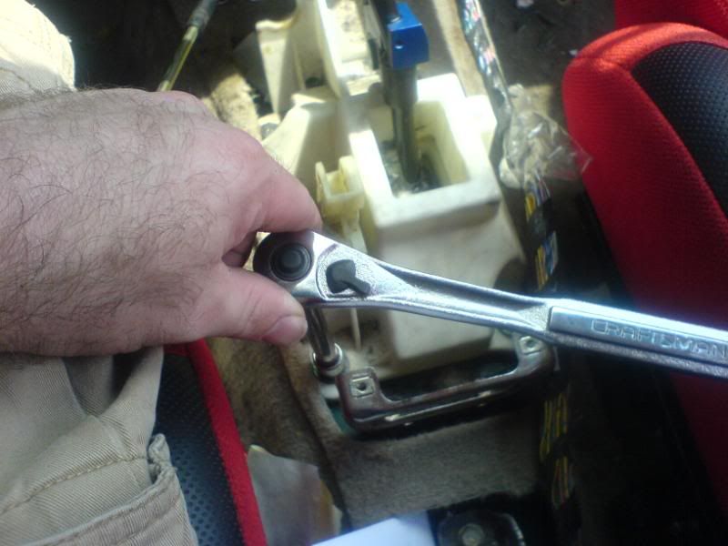

Now you can unbolt the shifter:

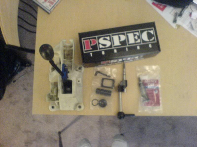

Now on to the fun part disassembly and assembly of the shifter:
Make sure you have all the pieces ready to go!
here what you need:
