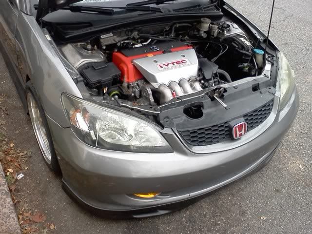

Basically same process as the rears and we ended up with this :hs:
when we put them on and lowered it all the way to the perch i still had a finger gap so u guys no what that means CUT PERCHES!!!!! :tup:
after both of them where finished ended up with this
and in she goes
little pic of are mess :D
