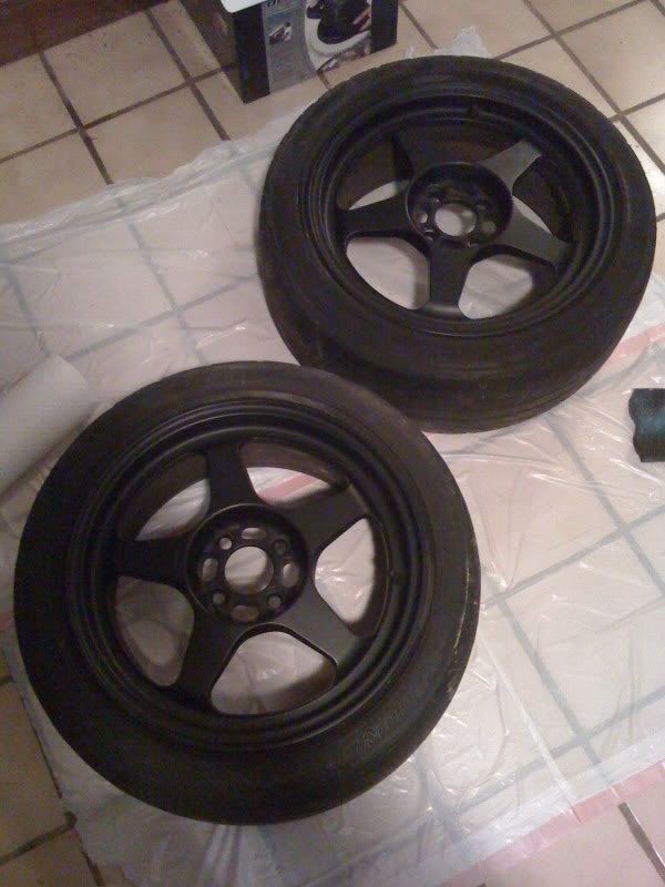

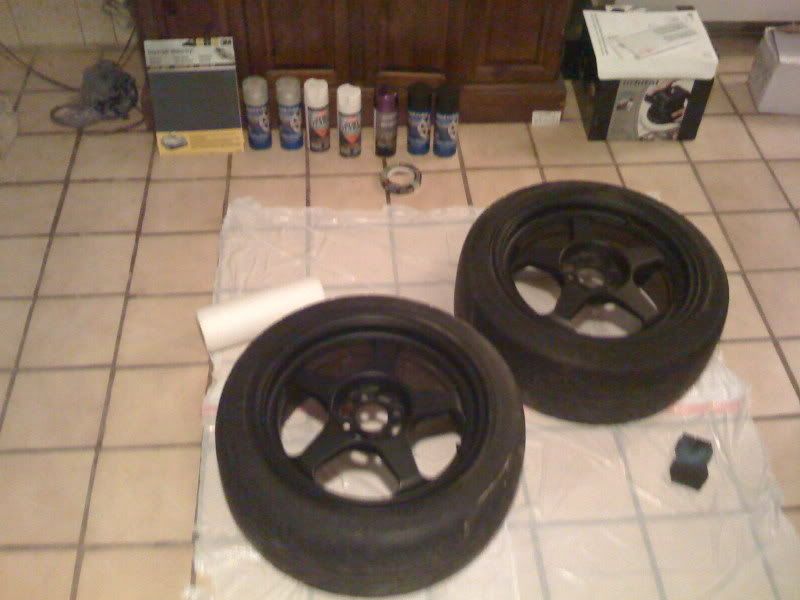

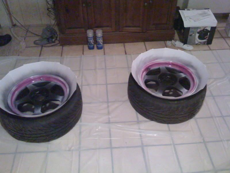

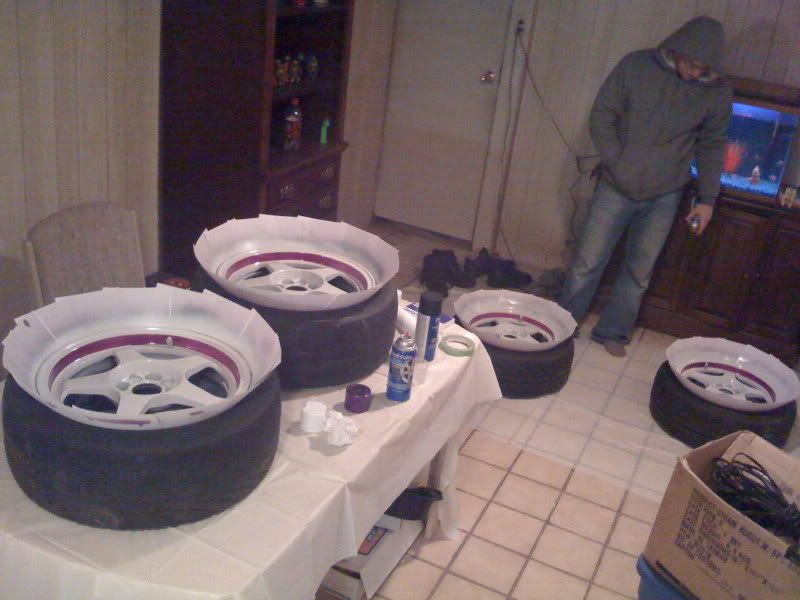

ok so i wanted to be different, so i painted my slips white and purple, here is the process.

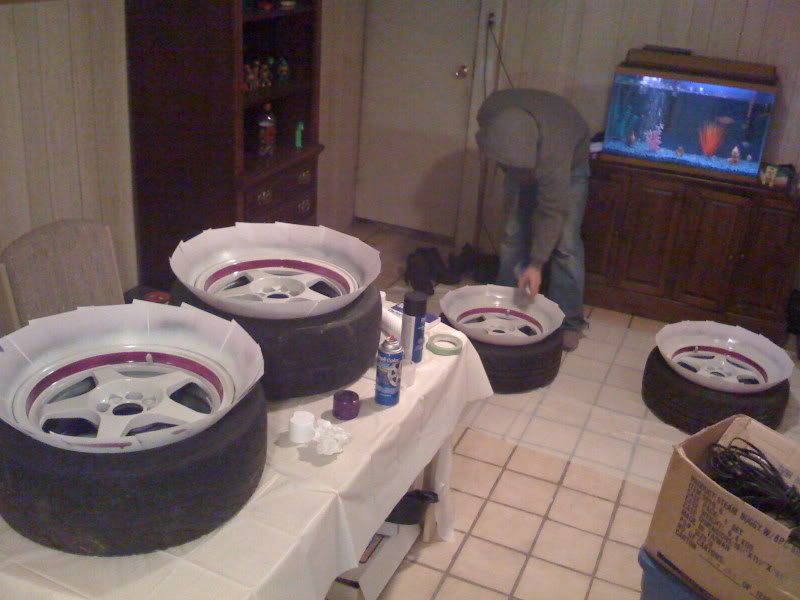

oh btw, there is over a foot of snow outside so i made a make shift paint shop in my apartment with fans and space heaters. was able to fit 2 on the living room floor and 2 on the dining room table.

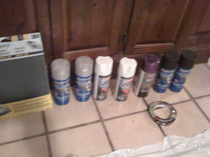

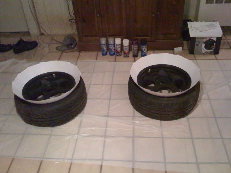

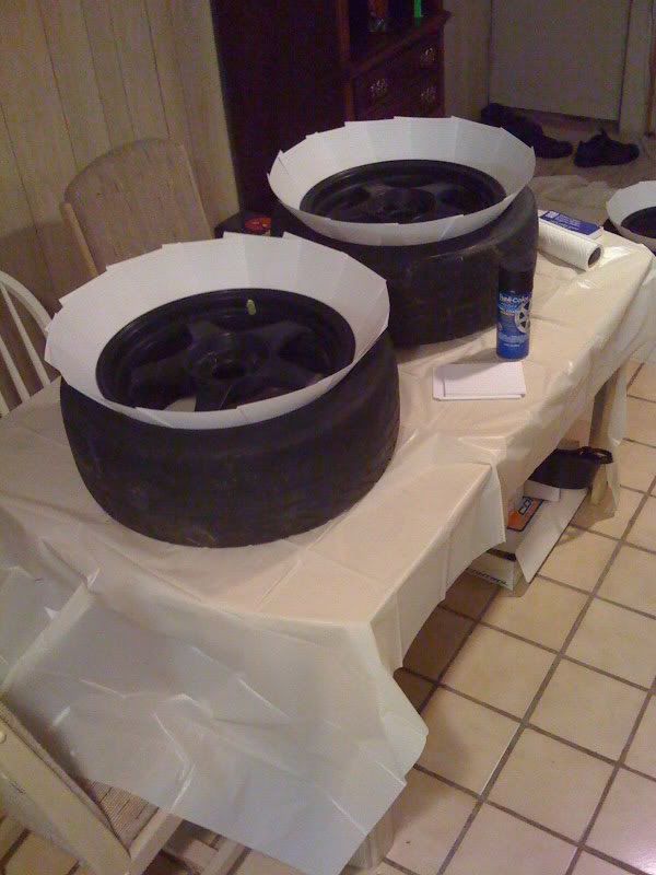

Getting ready to be prepped
All my shit
Sanded and Cleaned

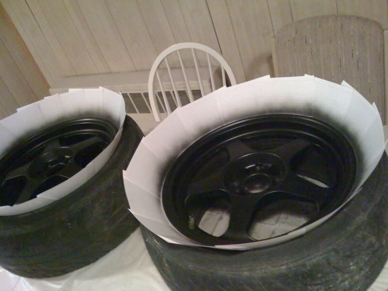

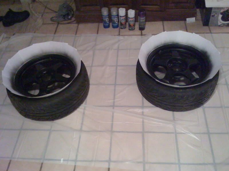

Ready for primer
First coat of primer ( did 2 coats )

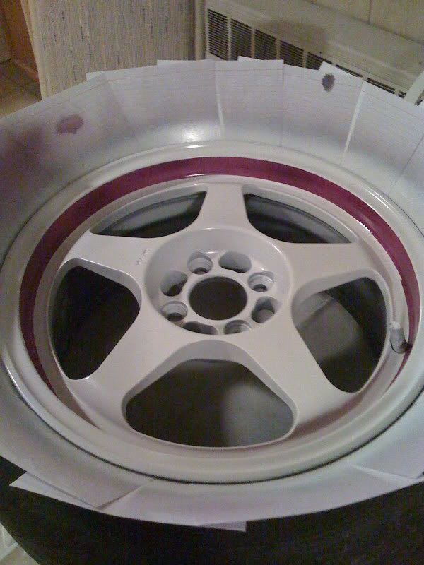

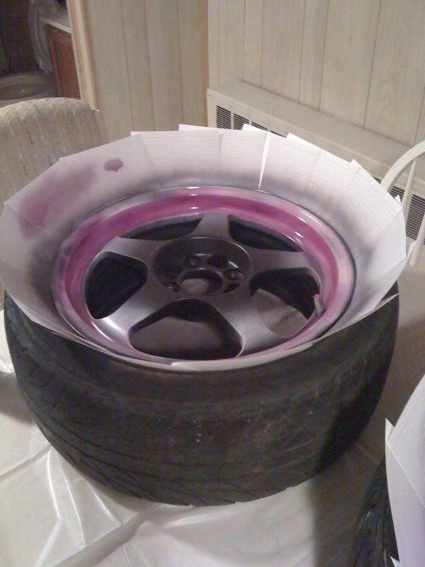

Purple lip sprayed on (had to spray white cause the purple wouldnt show on the primer)
Forgot to take a pic of taping off the purple lip

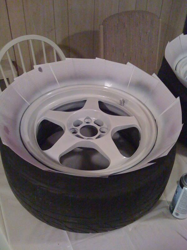

First coat of white ( did 3 coats )
Took the tape off

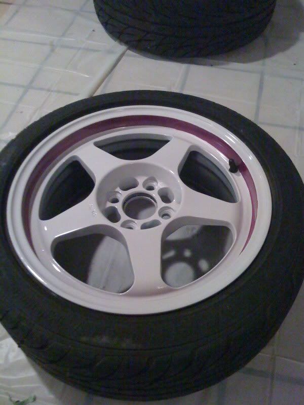

Clear going on (did 3 coats)

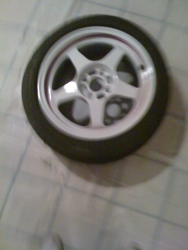

Finished product
sorry for the shitty pics taken with my iphone

Hot damn.. Finished product looks sick, so shiny and smooth. Did you follow the repaint your own wheel DIY? Looks like you did a better job, you should make a DIY out of those pictures :dunno:.

no i didnt follow the DIY. its very easy to do. i started at 8:30 with cleaning the wheels, then sanded it, cleaned them again, prime, paint, clear. done. finished at 12:30
Ahhh.. What grit did you use to sand them with? Did you only sand when you prepped? Or did you primer, sand, primer, sand, paint, sand, paint, sand, then clear?
I usually paint stuff how you do. I do sand, primer, paint, and clear. I've never done all the sanding in between coats. Just wanted to ask if you did, because it came out pretty damn good if you didn't. Looks so smooth and shiny :tup:
