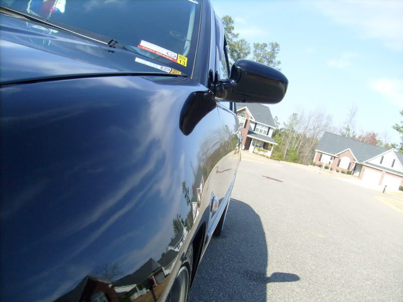

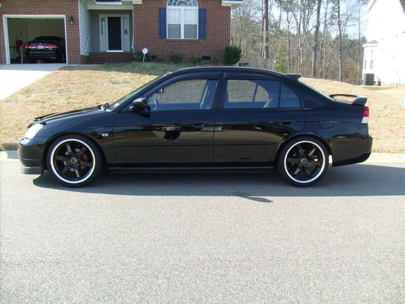

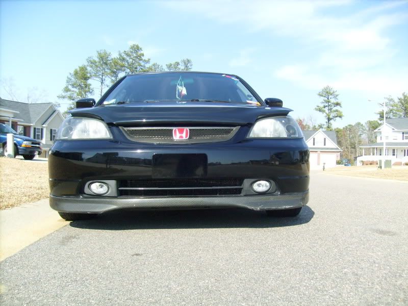

Some updated pix of my car detailed....
I need to paint and add my side skirts and get a type r rear (it looks so high, lol)

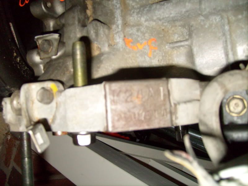

Well it's happened.... I FINALLY GOT MY K24A1!!!!! Will post some pix once I got it up on the engine stand and start to clean it up and replace parts prior to dropping it in.. I still have to buy a few things.... big things like a tranny, the motor mounts to name a few.
5/9/2011

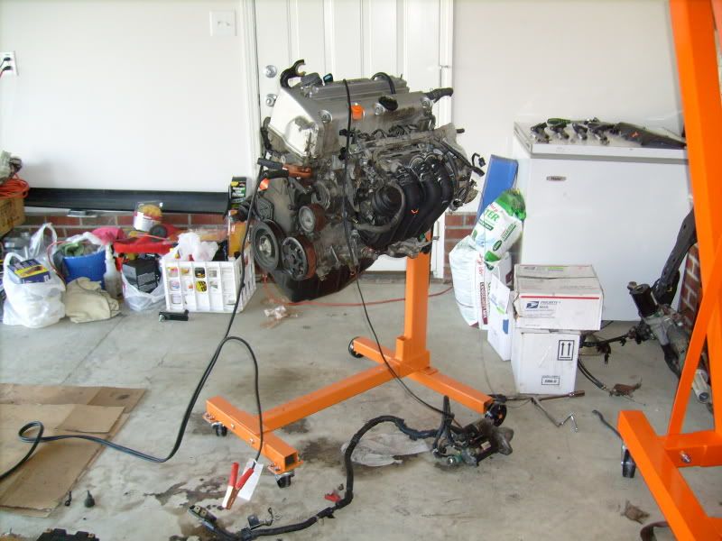

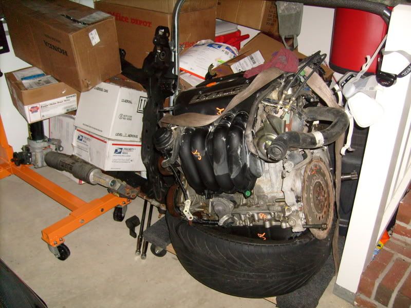

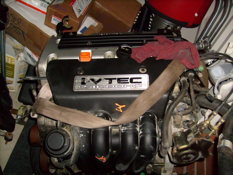

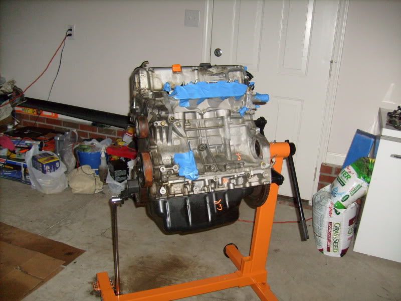

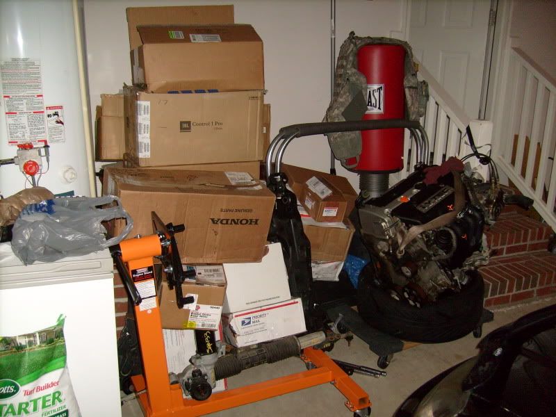

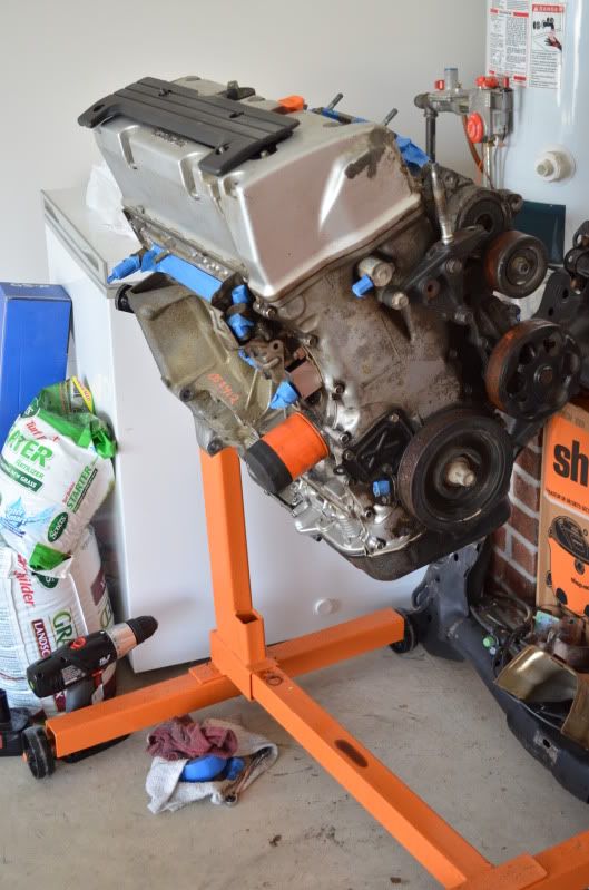

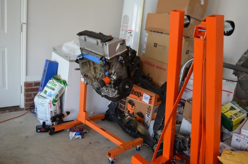

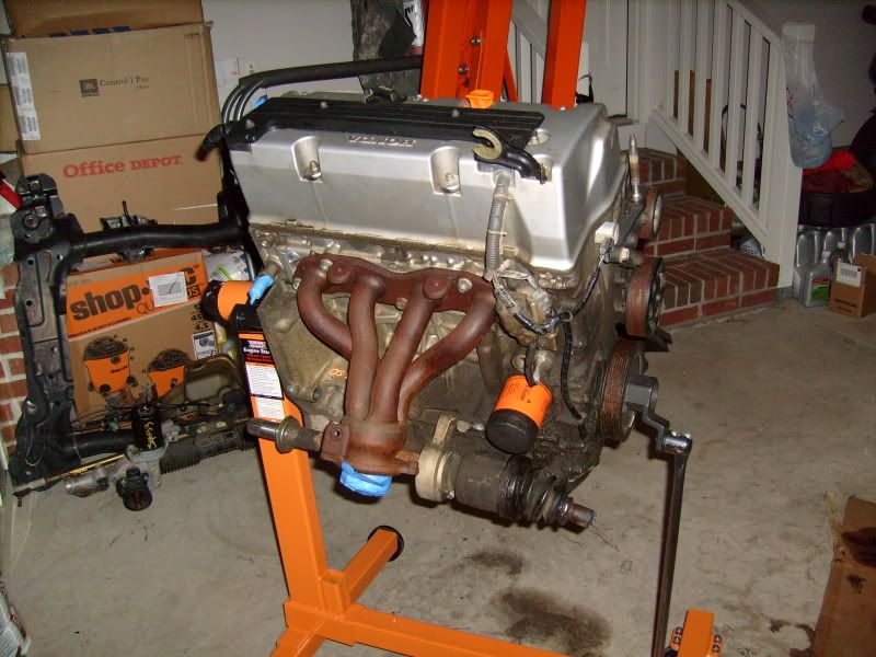

And here are the pix finally... still not on the stand but it'll get up there and I'll start getting it torn apart and cleaned up!!!
And my mountain of parts that I've been accumulating for a while now....
More to come hopefully this weekend or sometime this week if I can find some time and hopefully some help to get it up on some spare tires and on to the stand... we'll see but I'll definitely keep this thread updated with every little update i can....stay tuned!!!

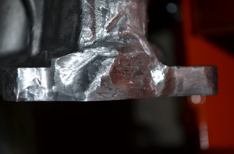

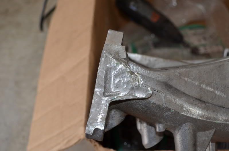

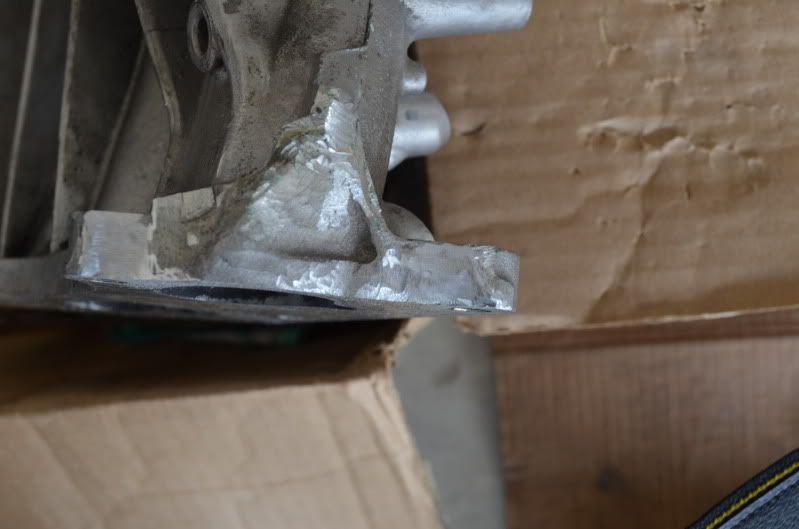

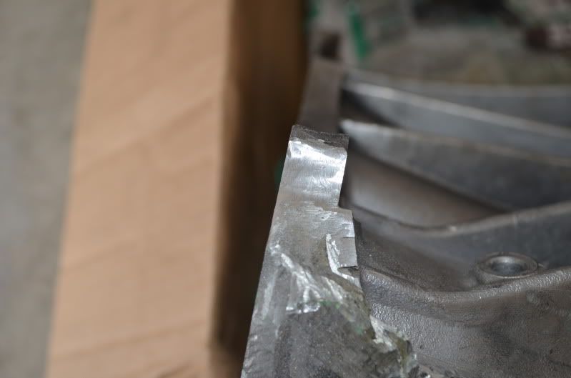

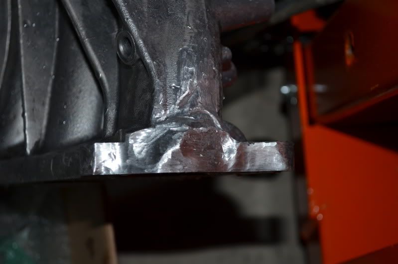

Very small update... I should have continued cleaning up my engine some more but instead I clean up the RBC some. Where the cut/mod was to be in order to fit to the K20 head....On to the pix
Before..
After...
