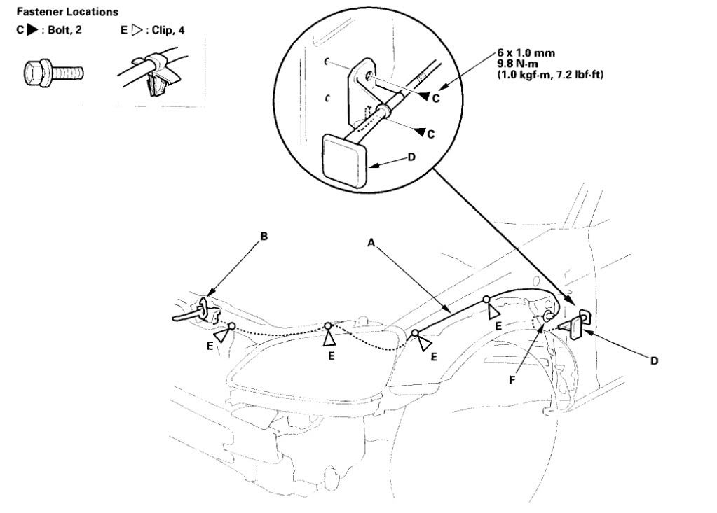

I'm having this problem right now. Even when it's not raining (and it hasnt rained here for like 5 days) my driver side floor is soaking wet. The plug (F) is still on and I don't know where the water is coming from and it's never dry. Anyone have any ideas on where to check?
