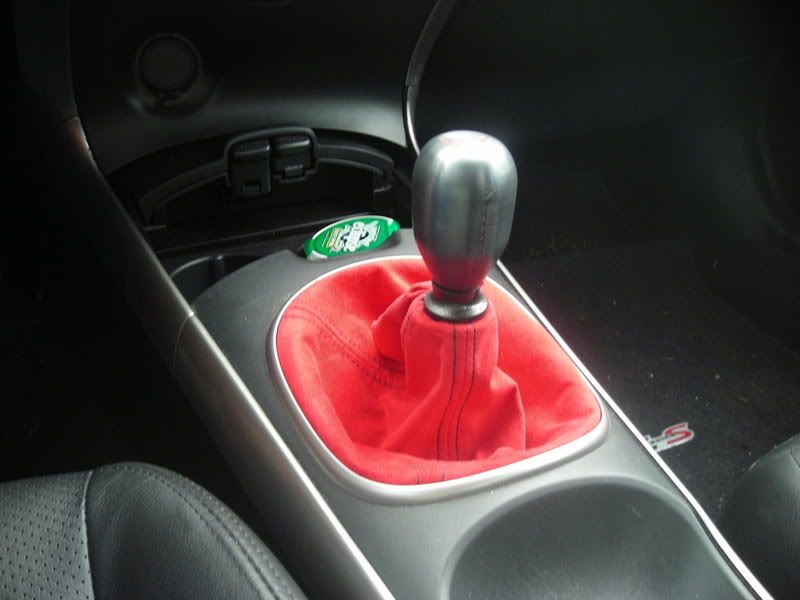

the momo knobs do not screw on to the shifter rod, they use set screws to attach to the shifter rod, the boot colars then screws on the knob outer threads.
MOMO KNOB
MOMO knob with set screws (not internal threads) and knob outer collar unscrewed:
Then the MOMO "Endurance Finisher" as they are called, screw to the bottom of the knob above:

well I believe that the center console must come off to get the boot off. I'd then untie the boot or cut the zip tie, Or use a "O" ring

ok
take off console
thread on that piece
then with the consol above the shifter do this
disreguard allen wrench.
Then set the console down and attach it, then screw the knob or allen wrench the knob down.
