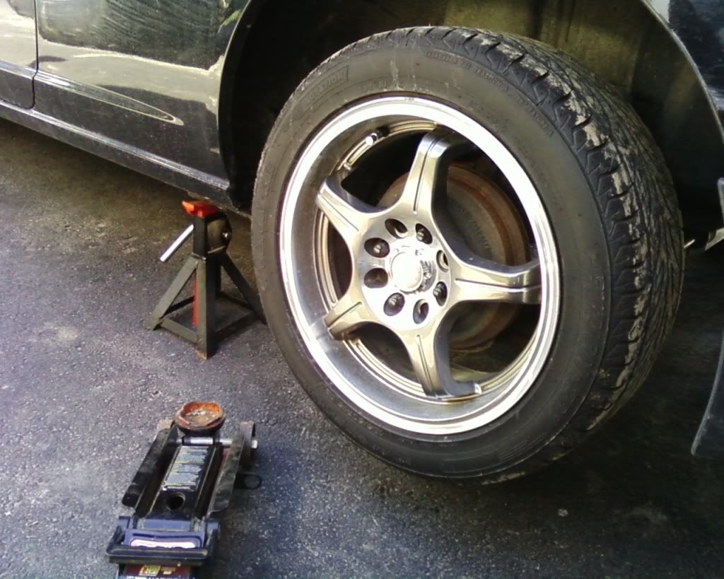

So first things first. Gather all your tools:
-Torque wrench good for 43 ft-lbs (only torque used)
-the correct bit for LCA bolts
-Ratchet set (Only need 19mm for the LCA- Chassis Pivot bolt)
-Torch (for those seized bolts)
-Jack & Two jack stands
So now you will want to jack up your car. Mine is so low I couldn't get the jack under the sub-frame with a block on top, so I jacked using the trailing arms. Once jack is high enough slip a jack stand under jacking point to hold the car up on both sides.
Remove the rear tires
