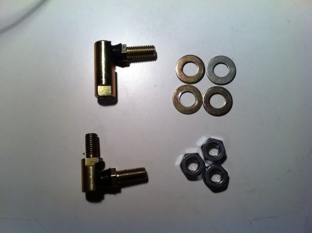

Not to long ago my rear endlinks finally went out so I started searched around online for DIY's to see how other people were diying their endlinks. For the most parts everyone uses rod ends and a bolt which is cool but I just didn't like them for some reason. I wanted something more like the corsport endlinks. While looking online at http://www.midwestcontrol.com I stumbled upon these male, male(EMMS-10) and female, male(ESM-10) metric ball joints.
http://www.midwestcontrol.com/part.php?id=27
http://www.midwestcontrol.com/part.php?id=72
So I decided to order 4 of EMMS-10 and 4 of ESM-10 so I could replace my front and rear endlinks. My grand total to build 4 endlinks including shipping was about $50 not the cheapest solution but I am happy with my results.
Materials required per side. 2 sides required per sway bar.
1 EMMS-10 --ordered from midwestcontrol
1 EMS-10 --ordered from midwestcontrol
3 Metric M10 x 1.5 nuts --bought from local hardware store
4 Metric M10 washers or standard size equivalent --bought from local hardware store
Some loctite --bought from local hardware store

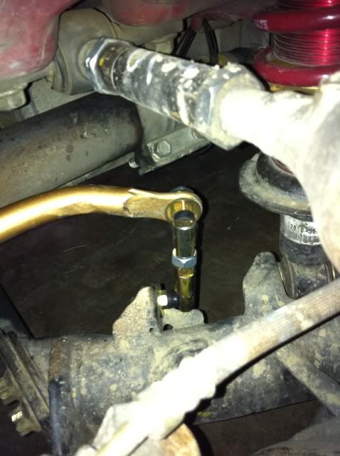

Pic of all pieces for one endlink
Everything Assembled
Next to OEM endlink little shorter than oem but I haven't had a problem with it.
Installed
Edit: As of 8/03/2012 I've put about 23k on endlinks with rsx rear sway and 02 civic front sway and endlinks are holding up great.

I'm not that hard on endlinks since I don't autocross or track my car. Worst stress my endlinks face is going in and out of driveways loading up one side then other. So far I've gotten 15 days on the endlinks and there still running strong.

So... First off thanks for putting this up. I recently (yesterday) found out I needed new endlinks, and I appreciate having an alternative. Couple questions that I can't seem to decipher. So far the past month they've held up pretty good? It was $50 for a set of 4 endlinks (2 per sway, front and rear)? Or is it $50 for ONE set (one sway)?
And the picture you have up looks like the endlinks are attached backwards from how the stock endlinks were attached. I'm assuming it doesn't matter, but I just wanted tl know why that is. Maybe I am just looking at it wrong.

Just installed mine yesterday. Had to look at the pictures a few times and look at the old endlinks and put them on the sway 3 different ways before I finally got it lol. Glad I didn't take it to a shop. They might have just installed it any which way.
