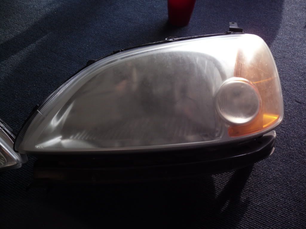

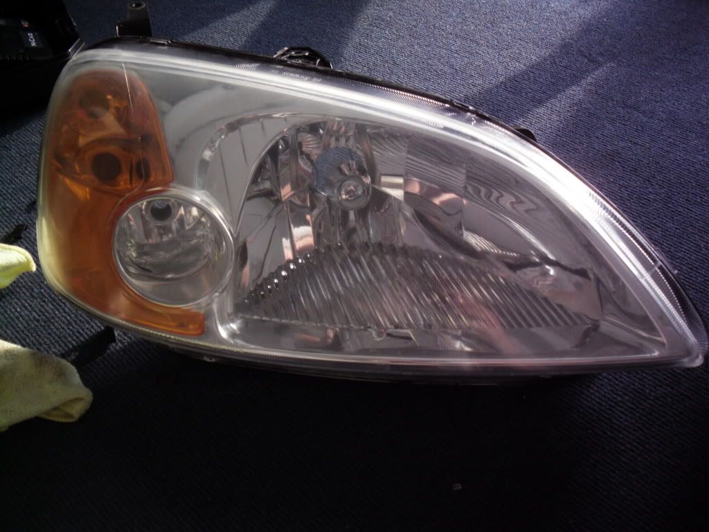

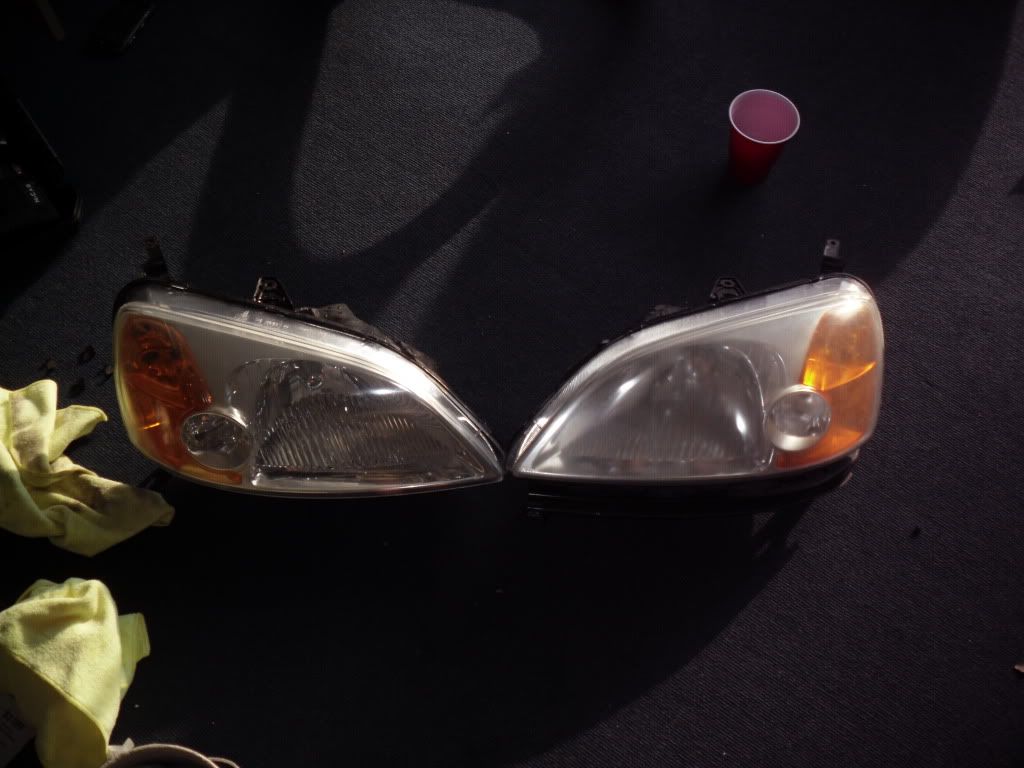

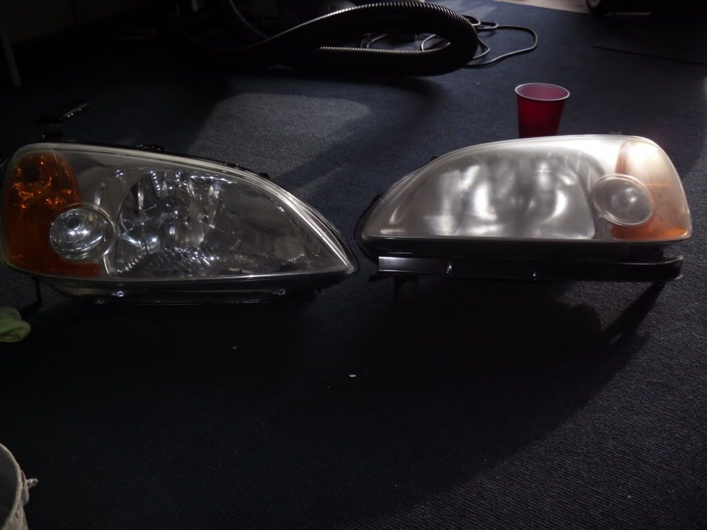

Basically it was clean them, use low grit sandpaper on a drill. Clean the, use high grit paper on them. Clean them, wet sand them with really high grit sandpaper. Clean them, use buffing compound, and let it sit. Then clean them one final time. Took about 45 minutes per light. Ive done it before on REALLY bad lights and it did come back a little but oh well, it looks good for now, thats all that matters :tup:
