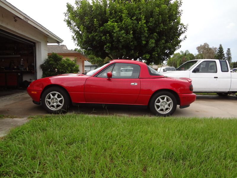

I picked up a '94 R-package. The car has a few small dents, a bent fender, faded paint, and the AC is good for droping ambient temps by at least 3 degrees. I feel like I paid way too much for it but there just wasn't much selection locally, I was going nuts with no car, and I really liked the R-package options: torsen LSD, no ABS, power NOTHING (steering, windows, locks, etc), and came with a hardtop. I picked it up bone stock, aside from having the muffler cut off, with 98,676 miles on it, for $4400.
First picture after I got it home:
