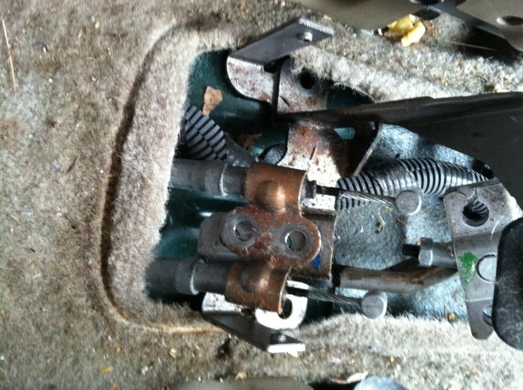

there are 5 12mm bolts holding the e brake in, remove them.
the cables can stay in the car and be reused
