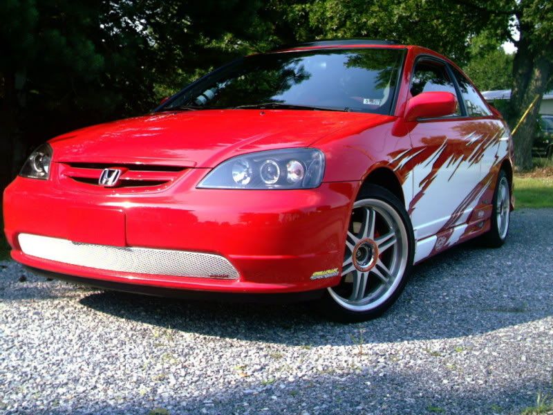

Phase 1:
Exterior Modifications-
eBay angel eye projector headlights
Grill craft front lower grill
Kaminari front lip
eBay Mugen rep front lip
WingsWest G5 sideskirts
WingsWest G5 rear lip
APC Chrome taillights
Custom Graphics
Konig Toxxin 17x7
Kobe Viz-5 17x7.5 +42
Suspension Modifications
Ground Control coilover setup
Stock Struts
Eibach front camber kit
SPC rear camber kit
DC Sport rear tie bar
Interior Modifications
Corbeau CR1 race seats
Auto Meter a-pillar dual gauge pod
Faze gauge oil pressure gauge
Faze gauge narrow-band air/fuel gauge
Engine Modifications
D17a2
DC Sport header
AEM cold air intake
2.25" cat-back exhaust
3A Racing muffler
Phase 2:
Blacked out OEM headlights
Mugen Style Carbon Fiber Front Lip
Mugen style front lip
JDM style front grill with custom Ek9 Civic badge
"Factory Pack Black" painted roof
JDM style yellow fog lights
OEM style VIS carbon fiber hood
'04/'05 OEM tail light and rear harness
17x7.5 +42 Kobe Viz-5
Suspension Modifications-
Ground Control coilover sleeves
Stock Struts
SPC rear camber kit
Energy Suspension rear sway bar bushings
Corsport racing endlinks
Progress 22mm rear sway bar
Progress rear tie bar
Skunk2 polished rear lower control arms
Interior Modifications-
Skunk2 5spd counter weighted shift knob
Type R style shift boot
Carbon fiber trim
Auto Meter Ultra-Lite II narrow-band air/fuel ratio gauge
Auto Meter Ultra-Lite II oil pressure gauge
Engine Modifications-
D17a2
DC Sport header
AEM cold air intake
Skunk2 Mega Power muffler
Phase 3: The Build 7/2011-4/2012
Polished wheels DIY:'02/'04 RSX-S/Base Wheels DIY Polishing
OEM headlights
OEM Aero front lip
Aerocatch Plus Flush locking hood pins
Polished OEM RSX-S wheels
ARP extended wheel studs
ClubRSX lug nut adapters
VMS "forged" aluminum lug nuts
Suspension & Brake Modifications-
Koni sport yellow struts
Ground Control Koni adapters
RSX Neuspeed strut tower brace
SPC RSX-S front camber bolts
SPC Civic rear camber kit
Energy Suspension rear knuckle and trailing arm bushings
Skunk2 clear anodized rear lower control arms

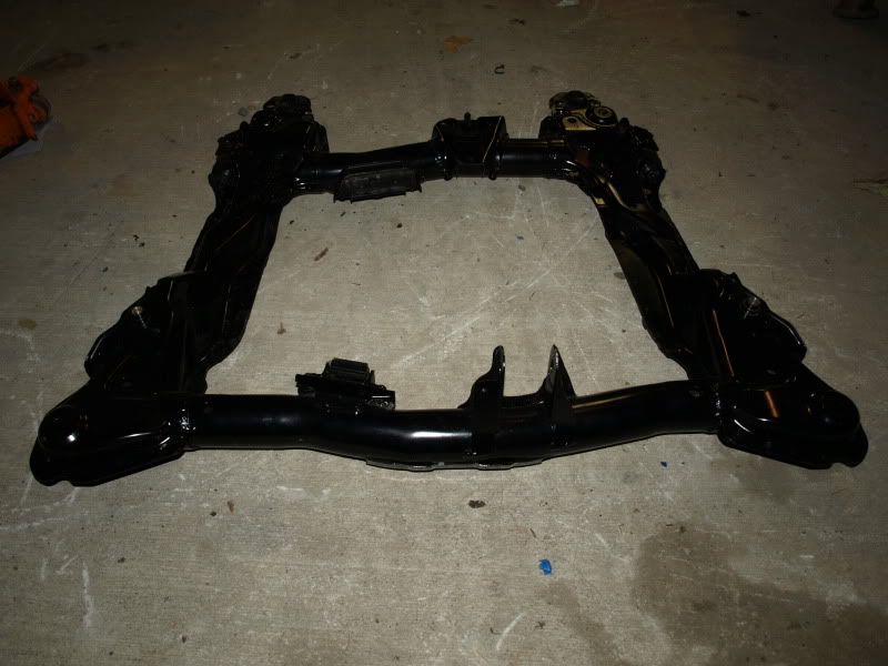

2005 RSX-S front subframe
2002 RSX-S hubs, spindles, rotors, and brake calipers
2005 RSX-S rear brake hoses and emergency brake cables
Skunk2 6spd counter weighted shift knob
2003 Front RSX-S seats
2004 RSX-S steering wheel
Carbon fiber trim
Neptune Tunerview II
Engine and Supporting Modifications -
2005 RSX-S K20Z1

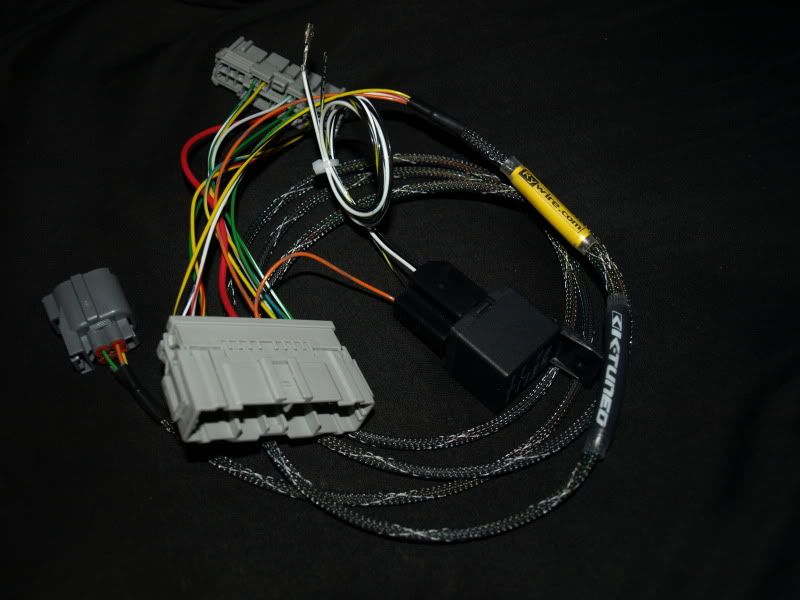

2003 RSX-S ECU with Honda Kpro and engine harness
Dc5R valve cover
Dc5R coil pack cover
Buddy Club oil cap
Megan Racing long tube header

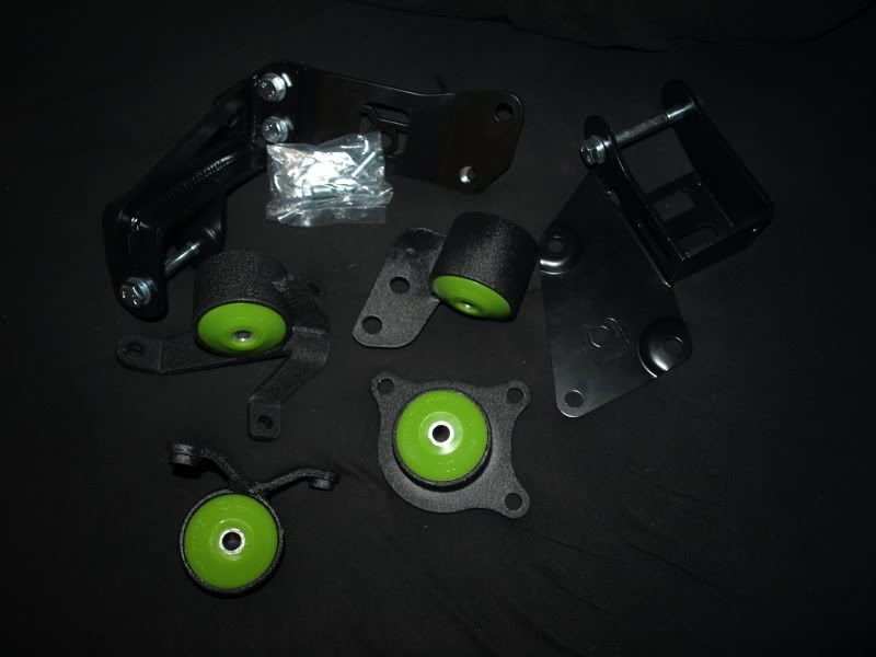

Innovative 75a swap mounts
Karcepts A/C and P/S delete
2002/2005 Civic Si Mishimoto radiator
10" Mishimoto fan
Gates P/N 21229 upper radiator hose
RSX-S lower radiator hose
Hybrid Racing timing chain tensioner
ARP head studs

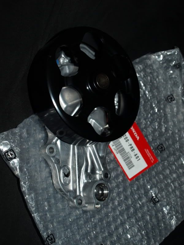

OEM Honda water pump
OEM Honda gaskets and seals
OEM Honda headgasket
ACT Streetlite flywheel

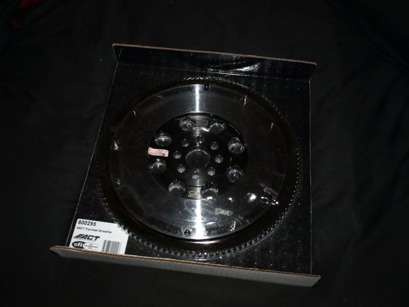

ACT Six-puck Sprung Heavy Duty Clutch kit
Civic Si RBC intake manifold
Hondata intake manifold gasket

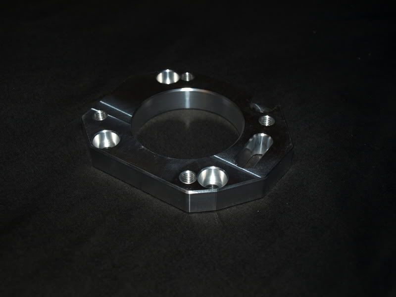

BlackWorks Racing throttle body spacer/adapter
Eg Civic throttle cable
Karcepts fuel rail
Walbro 255 fuel pump
Gates H209 submersible fuel line
Aeroquip stainless steel fuel line
Summit Racing -6an 40 micron inline fuel filter
Aeromotive A1000-6 fuel pressure regulator
Fragola, Summit Racing, and Aeroquip fittings
DIY stainless steel clutch line
Positive and negative battery terminal lugs
Custom battery bracket
Universal coolant catch can
RyWire dash conversion harness
Three inch KTeller exhaust kit
Vibrant Streetpower 1042 muffler

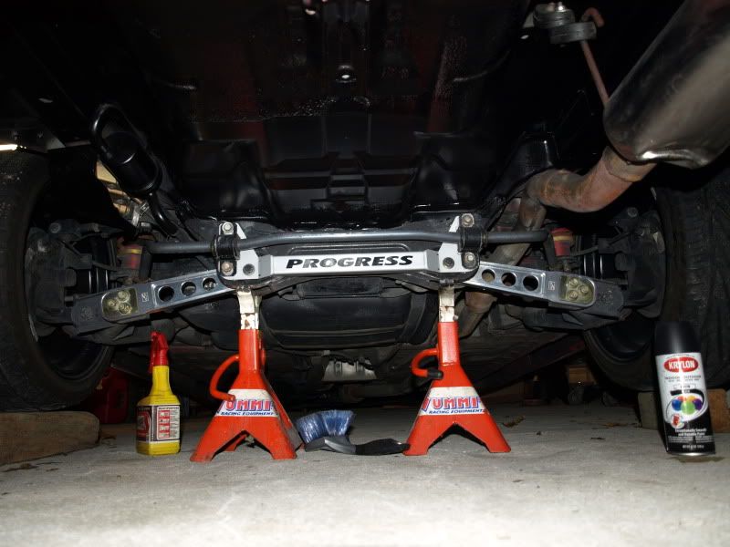

After my shopping spree and looking at a few builds on some other forums, I got tired of a few things on my car...One of them being my "custom painted" Progress tie bar...
Resprayed it the factory Progress silver and ordered a new PROGRESS decal.
Also started to clean up the undercarriage

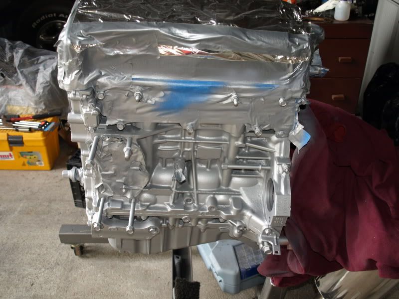

I had a friend come over to help adjust the valves because I have no idea how to... I took the valve cover off and was looking around inside the head for no real reason, Then I came across a very small spring.... Showed it to another friend and he then found a pin... Turns out that one of the springs and pins in the rocker arm assembly fell out during the reassembly of the head.... Long story short, The motor came back out. Timing cover, timing chain tensioner, timing chain, cam caps, and cams were removed.... Wanted to have the thing turning over on its own this weekend but I'm not sure what's going to happen.
Motor out, torn back down, reassembled one day.... motor put in and everything hooked up the next, then this....
